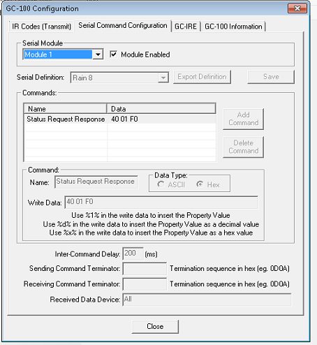

I'm trying to use the GC-100 device using the serial interface. I am unable to assign commands and when I try sending a command using the Generic Serial Definition and I get and error indicating The format of the serial command is incorrect. It must include the ModuleID. Sorry for such a newbie question. I'm sure this is something simple I'm missing. I've attached two screenshots that might help explain.

Well... in the latest version of HouseBot there is/was a bug where it wouldn't even let you assign serial commands from the GC-100. To fix that issue, here's a new interface dll that you can unzip and copy over the old one in your HouseBot/Plugins/Interfaces directory.

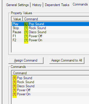

When you are assigning commands, they should all show a prefix in brackets that show the module number. That's what your trace is complaining about. See an example here:
