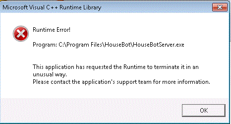

Tried to load/install this when it first came out, got an error message, and have been skipping the load ever since...until now. Tried again just to see what would happen:
web hbx err.gif (13.19 KiB) Viewed 48901 times
Not serious here. been skipping it all this time. But just in case I need to do something here to correct.

Steve,
Is this just when you run setup, or each time you start HouseBot?
Also, what version of Windows are you seeing this on?
Re: Error msg on loading Web Control HBX
Each HB start.
Windows 7 pro.
Got it. To fix this either:
  • Run HouseBot as an Administrator
  • Delete the web_control.hbx file in your Config/Import directory
  • Wait until the next version where the issue is resolved
Thanks. Thought I was running as admin. but maybe not. Will try it...
I can do without, have so far.. :D
Running HB as Admin corrected the import issue. :D
