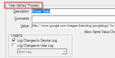

Is the Power State Property really a stock Power State Property, or another type that has a description Power State?
For example, here's an example of something that looks like a Power State, but isn't really.
If that's the case, I should probably check for "Power State" as a description too.
Bad Power State.png (6.82 KiB) Viewed 24681 times

Re: Echo/Alexa Capability
Post by incoronado »
That did it.
Thanks Scott.
