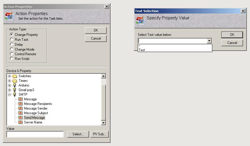

Purchased housebot recently and I am really happy with the way it is functioning, I just have a question about the SMTP device. I am using housebot together with stunnel and it is functioning as expected. The only problem is I have no option in the SMTP device to send mail. According to the help file the "Send Message" property should be set to "yes" in order to send the message, but I can not do that. The only options I have are "Test" and "*".

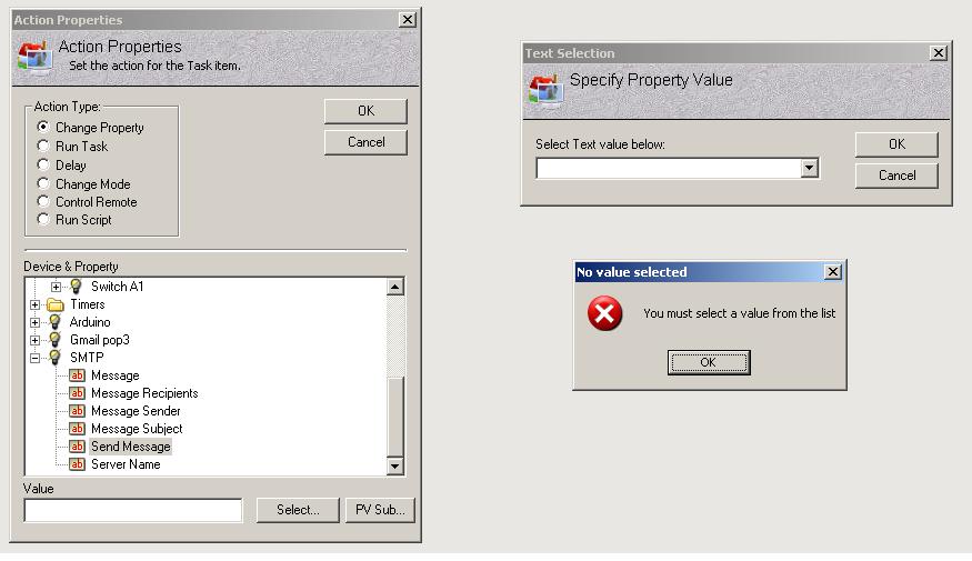

This does not seem to work, I still get an error that I need to select an item from the list. Below I attached an image (i hope) of the list of items I can select, and the error I get when I type in "yes". I also found out that there is no way to enter a username and password, so it will not work with a secured server anyway. But I just wanted to show you the error, maybe it is of help to you.
Selectable items for a task: Error when entering "yes"

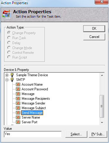

However, the screenshots you posted seem to be missing some properties from the SMTP device. I Don't see the Account Name and password properties for some reason (see my attached screen shot). I'd suggest deleting that device and creating it again.
From a task, you should be able to just enter Yes into the Value field, so I'm not sure why it's not working for you.
- Action Properties.png (40.88 KiB) Viewed 12561 times

As for the SMTP, this is really strange because in the help file there is also no mention of a username, password and server port field. (tried deleting and making a new device multiple times btw) All the fields that I have are listed and explained, the ones I don't have are also not mentioned. Your thoughts on this?
I assume you mean the dump file I posted in the POP3 post? Ah, well that's to bad.

Hmm... then I guess my conclusion would be that you are not running the latest version of HouseBot, or I have an SMTP device that I never released. Can you verify the version of HouseBot and the SMTP plugin you are using?
