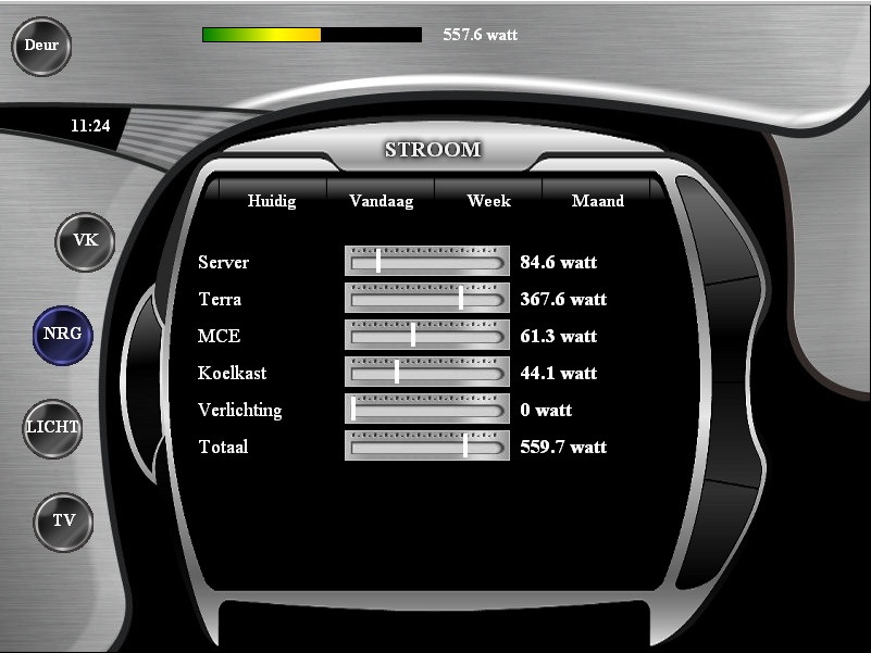

The easiest way would be to use a webserver, a (very) little bit of ASP / PHP code for getting/setting values and a bit of javascript to update values.
I've attached a screenshot of what I made it look like.
I can upload the needed files later today if you would like to play around with it.
Regards,
LostDreamer
Regards,
LostDreamer
- PHP / HTML / jQuery webpage for housebot control
- touchpanel.jpg (121.07 KiB) Viewed 18551 times
