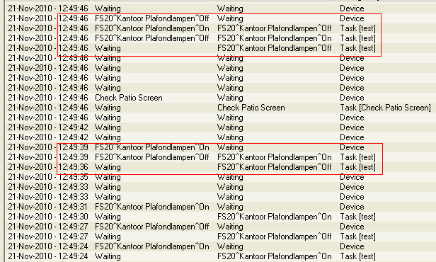

I went ahead and created a test. Results can be seen in the images attached.
The task is simple: Switch on a light in my office by sending a command to an Action property and a script handles the command. Wait 3 seconds and send another command to switch off the lights. Repeat this a couple of times.
Most of the times it works OK, but sometimes it just doesn't. Maybe because another task sends a command to the same Action property (Check Patio Screen), but this should work like advertised. You can see in the attached image that some commands are received in the Action property without the Delay in between.
Anyways; no such thing in script so I am happy.
@Scott: Happy to test anything you can think of! I can set up complex tasks real easy so it should take long to test certain conditions.

Re: TIMERS
That certainly doesn't look right to me either. It might be good to enable the 'Task' tracing (or Task Block in the advanced tracing) and run the same test.
Re: TIMERS
I am having a bit of trouble with isolating the task in tracing. I can't find tasks in the advanced list. Just the properties so I have to fiddle a bit with it before coming back with test results.
