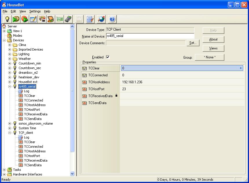

The title says it all. Find attached a software device to allow two-way communication with a TCP server. It is very basic and will need to have some sort of script associated with it that can parse the incoming data and clear the client buffer periodically. Questions, comments, feature requests...let me know. It was written using Visual Basic 2008 Express Edition and will require the HBDotNet.dll and the HBDotNetBridge.dll (both included in the download). See the ReadMe file that is included for set-up instructions.
HB_TCP Client_02122010.zip
(106.16 KiB) Downloaded 1497 times

Thank you for this. I downloaded the zip and read through the PDF file. I am wondering if this can work as an http listener?
It would be kind of nice to give HB a built in web server (so to speak). It wouldn't have to serve up html pages, but just respond
to simple HTTP GET requests. Anyway just a thought/comment.
Can you give some examples of the intended use of this plugin. It seams like one coud use it to access ethernet devices like network IP cameras?
Thanks, -Basi

Re: TCP Client Software Device Plugin
Yes, I was looking at doing a listener as well since the code is not that much different. I am finishing up work on two other plugins and will take a look at doing a TCP listener when I am done.
For my particular purpose, I use a modified version to interface to my SageTV server to allow me to get recording details, guide data, and control media extenders around the house. Scott uses his one-way version to control MS Media Center. I made a generic version while writing the SageTV plugin because I know a few others had requested this functionality in the past.
For IP cameras and such you probably want to look at the web browser I wrote a while back that will allow you to integrate an IE window into your software remote.

Hi Osler,
I'm using your plugin to control a dreambox satellite receiver and it work fine, but when i try to install another instance of that plugin and set the property TCConnected to 1 then Housebot exit to windows . Can You advice me how to do that without problem ??
Here the dump file.
  • ====== Begin Dump - Sunday, May 30, 2010 14:49:26 ======
    Server Version = 3.30.02
    ======== House Server Thread =======
    Thread Type = Device Thread [TCP Client] - [rs485_serial]
    Thread ID = E14
    Exception code: C0000005 ACCESS_VIOLATION
    Fault address: 09CBCE59 79E883DF:2D21BDAB 0Í"
    Registers:
    EAX:0A496498
    EBX:07A921D4
    ECX:07AAEE10
    EDX:00000000
    ESI:07AAEE10
    EDI:00000000
    CS:EIP:001B:09CBCE59
    SS:ESP:0023:0CB1FBA8 EBP:0CB1FBBC
    DS:0023 ES:0023 FS:003B GS:0000
    Flags:00010202
    Call stack:
    Address Frame
    09CBCE59 0CB1FBBC 0000:00000000
    09CBA9EB 0CB1FBF0 0000:00000000
    09CBA7C6 0CB1FC00 0000:00000000
    09CBA780 0CB1FC20 0000:00000000
    79E821B9 0CB1FCA0 DllUnregisterServerInternal+619D
    79FC1F92 0CB1FCC0 StrongNameErrorInfo+53EE
    79FC214A 0CB1FDC8 StrongNameErrorInfo+55A6
    79FC226E 0CB1FEA0 StrongNameErrorInfo+56CA
    074335F8 0CB1FED0 0000:00000000
    078C344A 0CB1FF08 HBDeviceRun+1A
    00406E8C 0CB1FF74 CxIOFile::~CxIOFile+3F0C
    785432A3 0CB1FFAC endthread+52
    7854332B 0CB1FFB4 endthread+DA
    7C80B729 0CB1FFEC GetModuleFileNameA+1BA
    ====== End Dump ======
Here the screenshot.
Thanks in advance .
This is a problem I am currently attempting to find a solution for. For some reason you can't have multiple device instances. Hopefully I can get this fixed soon. How many of these devices do you need? If you have the capability you can use the code I posted in VB express and compile a new dll with a slightly different name for each device you need.

Thanks for the quick response,
I need at least 4 TCP device, 2 satellite receiver and 2 rs232 over tcp.
I already tried to re-compile that dll, but I'm not an expert about visual basic and dll. I can try again if You drive me to the correct path, otherwise I will wait until You sort out the problem.
There are others who say they are not seeing this problem when using the dotnetbridge so let me poke around. I am obviously doing something wrong, but it is unclear to me at this time exactly what that is.
roussell is looking at the source for the DotNetBridge and may have a solution.
If a solution is not forthcoming by this weekend, I will compile 4 separate dll files for you to use to bridge you until the DotNetBridge issue is resolved. :wink:

Do not worry about that, I have found another solution.
I'm usnig Http request instead of a telnet connection, it is much faster than a telnet connection and is connectionless.
I use,
"http://"192.168.1.122/web/getcurrent"
to get a xml code, and a vbs script to parse it.
But I will need Your plug-in after for the virtual serial port.
I want to say thanks to Osler and all other valuable members of this forum.
