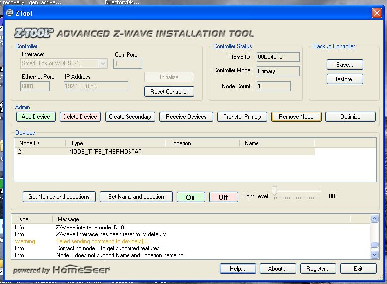

Re: Zwave adapter and thermostat does not communicate
Well I used the program you suggested for my adaptor. I was able to see the two piece of hardware (zwave) but I am not able to turn the devices on and off on the homeseer zwave program. I am using the WDUSB-10 zwave under the drop down box. There was no selection for the Controlthink or ThinkStick. I am going to try everything again when I get home from work today.
I think I have it on the zwave network. The homeseer program have given me node id for the 2 devices. The usb controller is number 1 and the thermostat is number 2. But I could be wrong.
What is the firmware version you have for your zwave device. Mine is 2.66. I was reading a forum post that shows that the zwave device might need to be downgraded.
I have version 2.76.
Do you have any other devices to test with?
