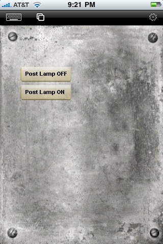

Here is a screen-cap of a theme I'm starting. The only thing I've really done at this point is the background. I placed a couple of buttons on there to test the response. I hope this is useful to someone, post if you have any problems setting it up. I don;t think I missed anything, but I may have been too high-level in some areas. Just let me know.
