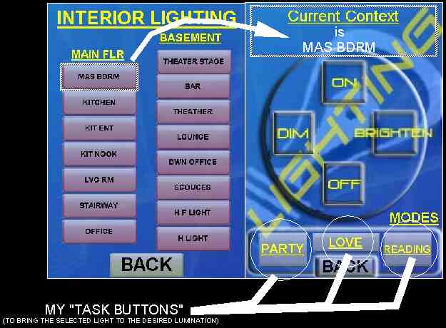

Attached is the idea I was looking for. You guys is probably right. And gave another idea to look at. I think I am going to create a property buttons that (when the context is changed) sends a certain property value for that context, then make a "task" will execute what I need.

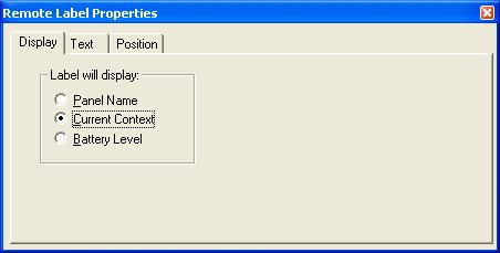

Do you mean this?
Re: How to parse the "Context" from HB
Yes. But I got the function I wanted to work by changing the button on the bottom of my panel to change property button then for each context I have a selected value. Then I have a task that executes whatever I want for the selected value.
