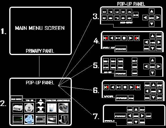

I have a pop-up label that I want to be the "primary" pop-up. Why use Pop-up panel instead of Primary? You might ask, I need to switch between the pop-up panel.
The problem i am having (under Pop-up panel) if I check the box under the Panel Change button; "Change Source Pop-up When Switching" it switch to the associated pop- up with is what the program is suppose to do.
It there a way to switch the pop-up panel instead of the pop-up panels layering themselves on a primary panel?
You say why not have a "Back to Previous Panel" Button
My answer "I just want to be difficult" LOL
Is there a reason why you can not "Change Source Pop-up When Switching" on a Primary Panel, Scott?
- POP-UP.jpg (37.06 KiB) Viewed 5972 times

In short all I want to to is:
From a primary Panel open a pop-up panel (which it does), then if I pick a different button it only layers the pop-ups on the my version of HB.
Example:
On a primary type panel
I click projector button --> pop up for projector comes up.
I then click DVD button --> pop up for DVD comes up.
But
If I click the projector button again --> the pop up does not display, because it is hidding behind the DVD pop-up (since I did not clear the projector pop-up to close; so it is still up but behind the DVD pop-up).
I was trying to do this without scripts because I can very easily make all my panels primary panel type. But I like the motions of the pop-up panels. Or I could just put a previous panel change button, but I really do not want to do that.
Any ideas?
