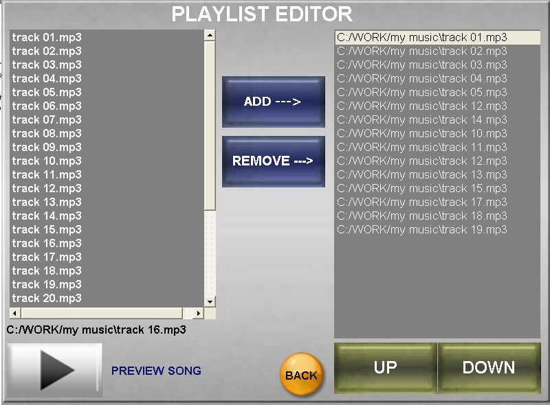

In my HB configuration, I created a panel that contains 2 list boxes for my Winamp plugin. .
Box 1 to the left I have a directory list box to display all my music files.
Box 2 to the right I have a list box, where i add the songs from Box 1 to create my playlist.
In between the two boxes I placed an add list Box to add selected songs to the playlist box to the right.
The question i have is; is there a way I can save the playlist i am creating from the alphalist in HB.
Currently what I do to retrieve the playlist I create is:
1. Export the AlphaList in HB
2. Convert to Excel
3. Remove all unnecessary fields
4. Save File as a .txt file
5. Open Notepad in Windows
6. Save file as a .M3u file
7. And the magic is DONE.
Is there a better way to retrieve these music file?
All I want to do is save the List Alpha files associated with the List box, to a M3u. file.
Attached is a picture of my playlist manager. NOTHING FANCY!!! So No Jokes.
