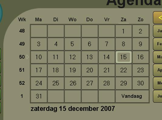

Just like a dynamic image now has a path and filename that can be changed, it could also have properties for x and y and if they change, the image should be redrawn at the new position. This doesn't need to be very quick so nice flashy things could be done with it, but highlighting a selected day out of a months calender could save 30+ images when the selected day can be highlighted with the same image at different coordinates. See attached picture. I created 37 different images to be able to hightlight each possible day. Just one of these 37 images is displayed in the same dynamic image with the same x and y coordinates. If x and y could be changed, I could have had just one small image and a script to adjust the coords.
