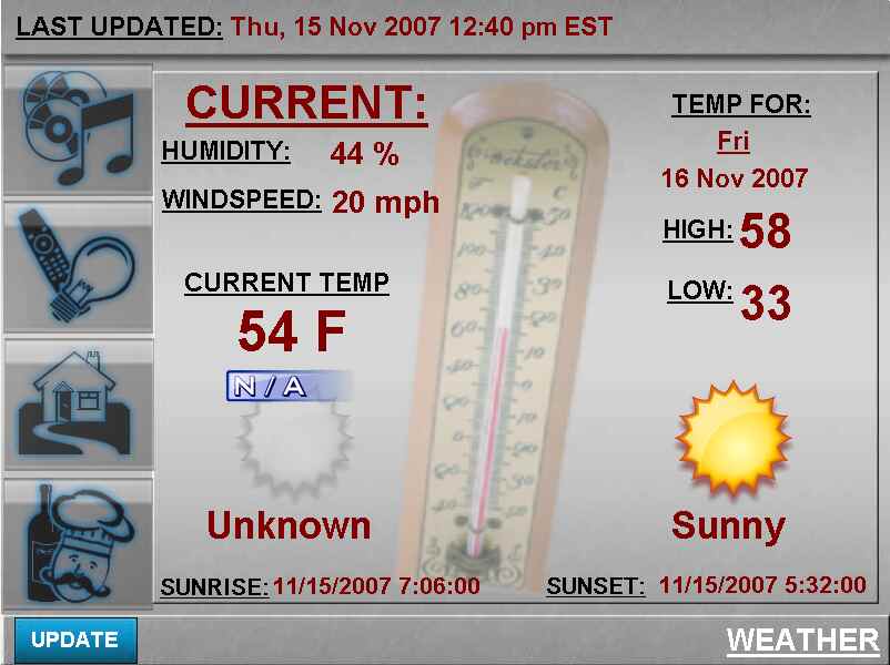

Hey Olser,
Can you post your finish Yahoo Weather screenshot or even others screenshots. I am just looking for some ideas. I recalled seeing someone's weather screenshot on the forum. But I can not remember where it was.
I would appreciate that.
Thanks for all you help,
James
I don't have a weather screen per se. I have 2 dynamic images that are displayed in the bottom right corner of my panels. Image 1 is the .png associated with the weather number for the current weather and image 2 is the .png associated with the weather number for tomorrows forecast. I have a property label overlaying image 1 that displays current temperature. I have 2 property lables overlaying image 2 that display the forecasted high and low temperature for tomorrow. That's really all I need...but you could go hog wild and pull in radar and all of that stuff in a seperate weather screen.
I went hog wild. LOL. I just came up with an elementary one for now. I will change it when I start finalizing my whole HB configuration. It is right on schedule for completion for June 2018. LoL
Attached is a jpg of my current screenshot.
