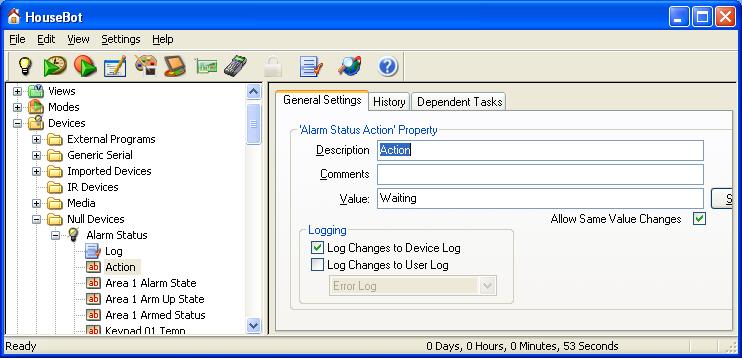

In the attached example you see that the action property is called 'Alarm Status Action' but the Description is 'Action'. So I stripped the 'Alarm Status' part.
Ok... Now I understand the problem. It has to do with the fact that there are actually two different property 'descriptions' One is the default description assigned to the property, and the other is the description that you may have renamed it to once associated to a device.
When a replicated device is first creating/associating it's properties it uses the property name and description set at the Device. If it fails to associate (probably because it doesn't exist on the remote machine yet), it then tries to create a new property using the same property name and description. Unfortunately, it uses the description you gave at the device level, and not the default one assigned to the property. Since property names and descriptions have to be unique, this creates a problem.
You could probably just create the same properties on the remote machine using the exact name and description that you did on the host machine and then try and create the replicated devices.
