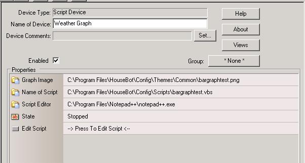

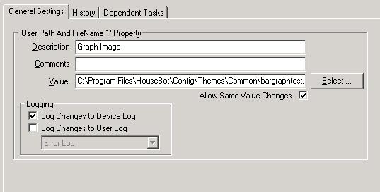

Also, below are two screen shots that show the script device and the image property

- graph device2.JPG (33.65 KiB) Viewed 4118 times
- graph device.JPG (21.66 KiB) Viewed 4118 times

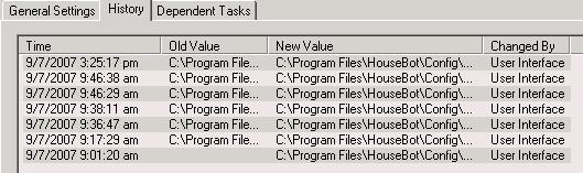

Actually no, not when the script runs. It shows a change in the history seemingly only when I open the file dialog box and change the path/file (I don't actually change it, I just re-select the same image file).
I'm running 3.00.01, BTW.
The "Old Value" and "New Value" fields are the same in the SS below...
- graphhistory3.JPG (31.58 KiB) Viewed 4112 times
