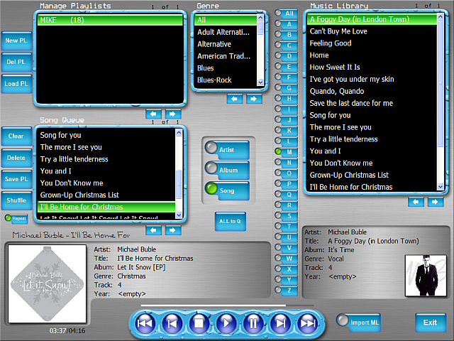

I have created a Jukebox script for cataloging, organizing, and playing music using Housebot I would like to share with HB users. It has a few components, so I'm looking for someone interested in helping me test it and create simplified installation instructions. If you are interested, PM me.
- THC Jukebox.png (286.26 KiB) Viewed 79537 times

THC Jukebox is everything you need to make a full-blown Media Server using Housebot. Took me a while to build and test this. I've installed this sucessfully multiple times using the instructions embedded in the THC Jukebox.hbx -- THCJukebox.txt. Trust me on this. You have to read them to get this installed. Don't even try it without reading them. There are only 10 relatively easy steps. The double-click feature on lists in HB 3.0 made it all possible -- love that feature. You really need HB 3.0 to get full functionality out of HBX Jukebox.
- THCJukebox.hbx
- (1.36 MiB) Downloaded 2300 times
Ok, I've got HBv3.x running and have imported THCJukebox. I've followed the installation steps as far as I know. Several observations: First, almost all my music is in WMA format. I don't see any reason why THCJukebox won't work for WMAs provided the Songs.cmd file is changed to locate all WMAs. That seems to work in my simple test. Either way, the songs.tmp file contains the located files. But nothing is displayed on the theme list box(es). Frankly, at this point I'm not sure what I'm supposed to see or do. Looks like either the database is not being built or is not being successfully queried. How to test?
Update: THC Jukebox is partially working now. Part of it is learning curve, part debugging install and music location and format issues. ID3 only appears to be fully functional with MP3 tags, so I will probably need to convert all my WMAs to MP3. But also, the double-click action in/on the Music Library List does not work, even though I added the control value back in per the instructions. I get an error referring to device ID 111 not existing. And its right - it doesnt. There are property IDs and values that point to it in HBDATA but nothing in the device table for 111. From the propertyvalueIRMap table entries, it looks like device 111 should be the winamp device. But my winamp device (music Player) is device 156. The properties associated with 111 start off with Alternate, Awaken, Clear, Exit... etc.). Clues anyone?

You're right. It will only work with mp3's at the moment. I only us mp3's because they are not system specific and they have extensive tagging functionality. That way I can rip them again using a different format or higher quality as I wish. I currently use VBR with a birate of 192 and I have to say it sounds really good. People will argue this, but it is extremely close to CD quality. I use Media Monkey (FREE) for cataloging all of my music. I embed album art in the MP3 and Media Monkey can find and download album art. I take a lot of care of cataloging my music. I have over 5000 songs and they all have accurate ID3V2 info in them with embedded album covers.
About your error message. If the double-click actions are not working there is something wrong here.
Make sure the Music Library list control has the following settings:
Device = Jukebox
Property = Selected Name
Make sure the Song Queue list control has the following settings:
Device = Jukebox
Property = Jukebox Playing Song
This is a bug in 3.0 that the double-click properties don't transfer on the import/export. Make sure all of the buttons have properties assigned to them. I have been working on a new version with over 20 backgrounds, and I have fixed quite a few minor bugs. I will find a way to get this posted shortly. If you find a command line, or VB script routine that can read and output ID3 data for wma files send it my way and I will see if I can integrate it. I thought I saw a version I would have to compile on one of the development websites I have visited recently. I might be able to compile it with the MP3 version so it outputs the info the same way. Better yet, maybe someone knows of something (Open Source) that will do the trick. I'm just offering up the work I've done and hope others might find it useful.
Device = Jukebox
Device = Jukebox
Thanks - I got the double click's to work. I had previously changed the list control props according to your install instructions (7 & eight), but they got gone somehow. Added the prop values for the jukebot device to the two lists. I think my only remaining issue is that if the ID3 tag info in support of WMAs. I need to research that, as I'm relatively ignorant on how all that works. I also need to figure out support of album art. Getting there! This is great!!
