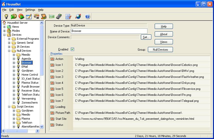

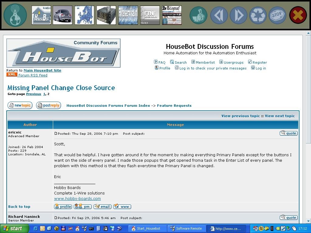

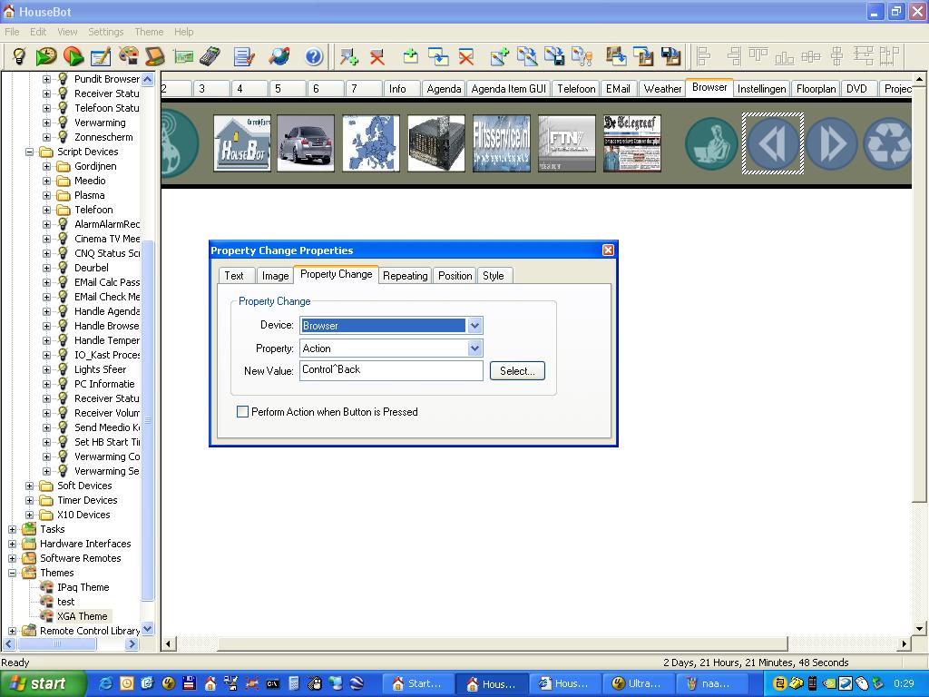

I have seen Oslers posts about the Web browser and figured I already had my browser script posted a long time ago. I guess I didn't because I can't find it in the scripts section.
So here it is. A theme control example, the HB setup and a screenshot. At least it will give some ideas bout how to get a browser going from vbscript.
Obviously I could create an export, but it seems Osler is doing a great job already.
