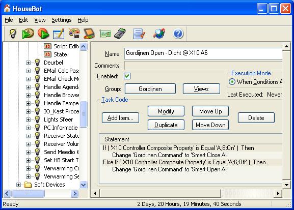

I do this all the time using the exit list and scripting. The exit list sets a property that triggers a sub in the script. The script will then close the panel and open the newly choosen panel. The only setback is that this works for all active remotes unless you define different script devices per remote.
Very simpel.
Create a NULL Device and store whatever value you want to store in the device property. Task, scripts etc all can do this.
Don't use properties which hold multiple predefined values.
Below an example where Gordijnen means Curatins. This is the NULL Device and the Command is the property in that device. Different values are set in the same property depending on the case. A script or task listens to this Command value and can act upon it.

Richard Naninck wrote: A script or task listens to this Command value and can act upon it.
"What we have here, is a failure to communicate."
Ok, so this is exactly what I am doing, as I described in the 1st post . .. and it works ok, as long as there is only the one instance. My task watchs the property, which is set to different values by different thumbnail buttons. When the property changes, I know a thumb has been chosen, and I close the panel.
I think we are using the same work around, which has the same problem that it isn't very scalable.
