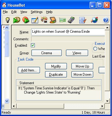

You could create NULL Device properties which are used as flags. So if your lights are turned off to watch a movie, that same task could set a flag. Another task that turn the lights back on again after the movie could check the flag first to see if it really needs to be done.
You could also simply use the Sunset value. That is what I use. So when I watch a movie, the lights are always turned off. If they were already off, nothing would happen anyway. If the movie stops and current time > sunset, then my lights will be turned on.
Last edited by Richard Naninck on Sun Oct 01, 2006 9:55 am, edited 1 time in total.
You could also just add a condition to the task to test if System Time.Sunrise Indicator == 0.
Actually that is what I meant to say. I don't check the time > sunset, I just check if the sunrise indicator = 0.

If you have status from everything, you just need to put a manual/automatic property controllable by a theme button in your system. I have that for my heating system. On automatic it switches automatically off when the alarm is armed and on manual, I can control the system according the current temperature.
So in your case when a switch is flipped to turn on the fan your HB system will know that and must flip the property to manual. When this property is in manual, the task that handles the automatic part won't work until it is restored in automatic. Then you can manually set it back to automatic using the theme button or think of a hundred other ways to get it back to auto. Let's say after a certain (extra) time, or the current alarm state or sunrise or...
You can even put an extra layer on top of this button and call it your vacation mode. Whenever the vacation mode is on, none of the automatic tasks will perform its duties. You could set vacation mode to on at a certain alarm state (ELK M1 can do that) or do it again using a theme button.
In my system that vacation button stops controlling automatic lights because I don't want the lights to switch when my parents feed the cats, automatic email retrievement is stopped (why bother my provider when I am not home), automatic heating is stopped no matter what setting the automatic/manual switch is in and my doorbell script stops doing certain stuff.
Well, actually the only thing I want to say here is that when you have all the status, it is just up to your imagination how you control stuff. And actually I believe that is your question. That's all for me...
