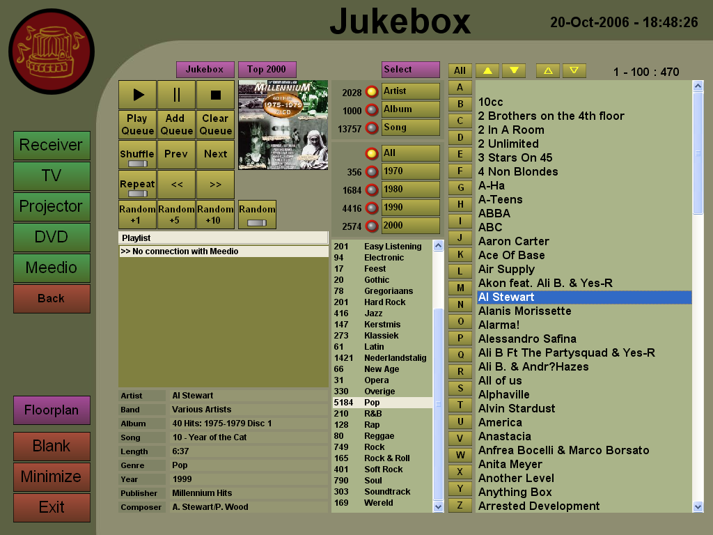

Both of them are possible. The music interface is up and running and I do the same for movies, weather, trailers, EPG and TV recordings.
Attached is a screenshot from my music panel.
Is is not very easy to setup and it requires a certain database setup. Al my albums contain a coverart jpg because I use ID3V2 (I thing) tags. I doesn't display coverart with ID3V3 tags when the coverart is set in the tag itself.
Also a meediomessages script is running to be able to display and setup playlists and display nowplaying and running time.
If you are any good in scripting, I guess you can set it up as well.
As for the movie subwoofer settings versus genres, this can be done as well. The genre is stored in the database and displayed on my movie panel. It is possible to sort the movies using the genre filter. When pressing Play form HouseBot, the Genre will be set and you can trigger a task to fire the right IR code for the sub.
