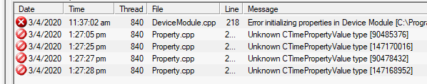

I did open the corrupted database with the SQLite browser but saw nothing suspicious. Did not attempt to compact. Went back to the live DB and HB, Without doing anything to the "corrupt" HBData, I was able to mostly delete a few unused tasks. Some deleted without issue, others delivered the above message a few times, then deleted as expected. Looking in the errors log, I found this: (The first error is unrelated; I get this every time I start HB.)
