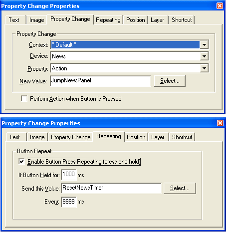

Attached one image displaying two tabs of the buttons property window.
PropertyValue "JumpNewsPanel" goes into the Action Property of the "News" NULL Device in the top image.
When the button is held for more than 1000ms the PropertyValue "ResetNewsTimer" is sent to the Action Property of the News NULL Device.
So two distinct values going into one property. A script (like your jukebox) monitoring the Action Property of the News Device can handle two different commands from a single button depending on how you press that button (short or long).
Code "snipped" would look like this:
Do
Sleep 120
Action = GetPropertyValue ("News.Action")
If Action <> "Waiting" Then
SetpropertyValue "News.Action", "Waiting"
Sleep 100
If Action <> "" Then
Call Handle_NewsAction(Action)
Loop
Sub Handle_NewsAction(Action)
Dim Data
Data = Split(Action, "^")
Select Case Data(0)
Case "JumpNewsPanel" : CurrentMessageTextID = CurrentRandomTextID
Case "ResetNewsTimer" : SetPropertyValue "News Timer.Running", "Yes"
End Select
End Sub

Thanks; that's pretty much what I thought and typed. But you described it better. And the script helped too. I'll try it out. FYI, my application is a two option Pause button for the DVR. Each option does pause the DVR, but one only pauses. The other one blanks the projector after 10 secs and raises the house lights... bathroom breaks- in the South we call pit stops. Currently I have two separate buttons that trigger two different tasks. But combining into one button will help de-clutter the panel. I'll bet I can find other applications for it too. Thanks again!
