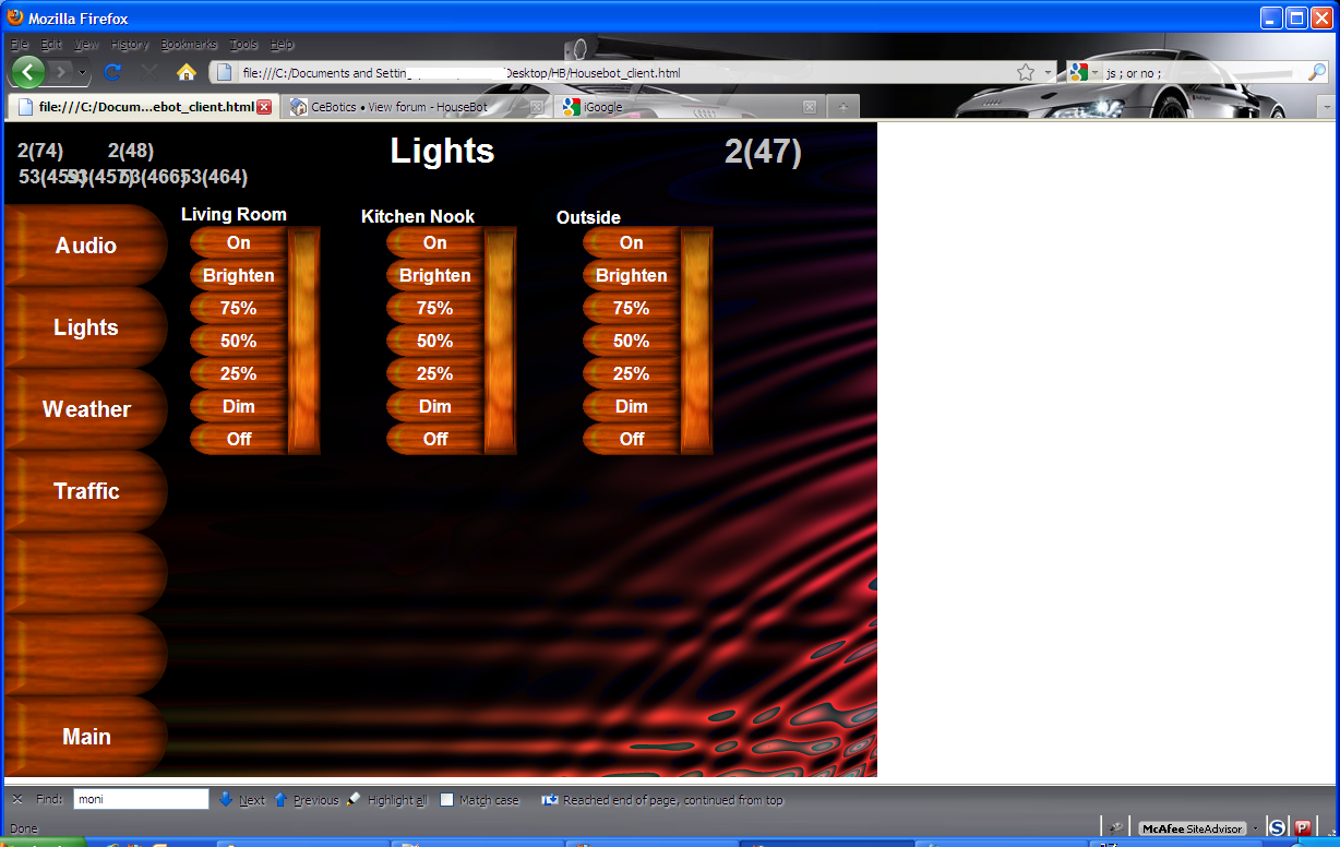

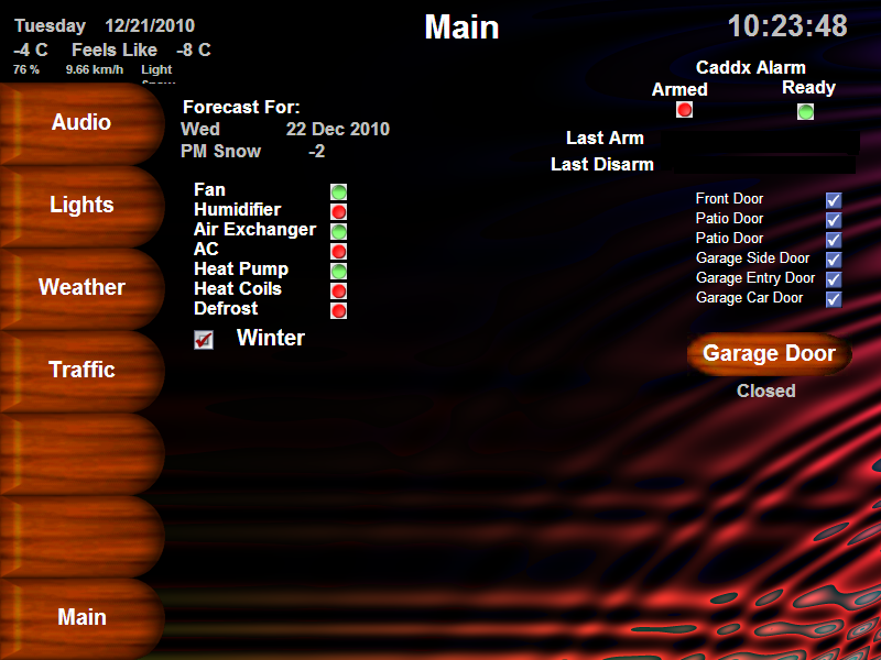

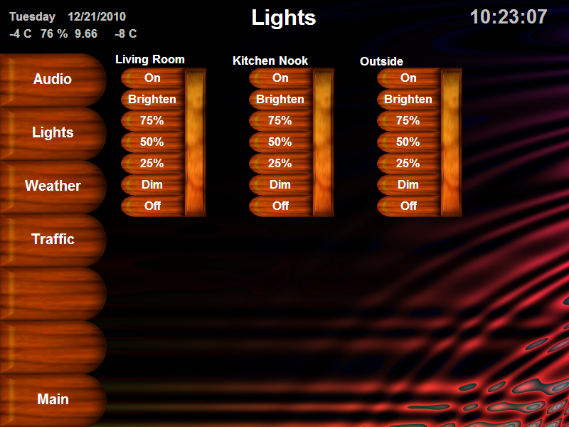

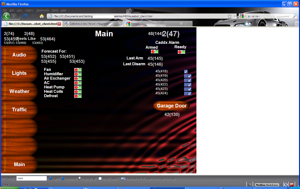

Update...
All of the items I am using in my theme have been implemented in a javascript UI! I've included some screenshots of my native HB remote and my javascript remote. Keep in mind this is only the user interface, which is why you see numbers where there should be text; and also why the indicators show all image states. There is no data coming from the Housebot server yet.
I was going to release this javascript with some basic functionality for using the native HB external control component, but I have decided not to release it. I will not be using the HB external control, so to add that functionality for an interim release would be a waste of time. I've also discovered some complexities that would probably prevent the javascript from working in quite a few cases. Rather than spend time answering questions and helping folks, I will put my energy into writing the plugin that will allow this browser client to work flawlessly.
I suspect it will take me another month to write the plugin, it might a be a bit quicker now that I am off work for xmas. :D
SWRemote
SWRemote
Browser
Browser
SWRemote
SWRemote
Browser
Browser
