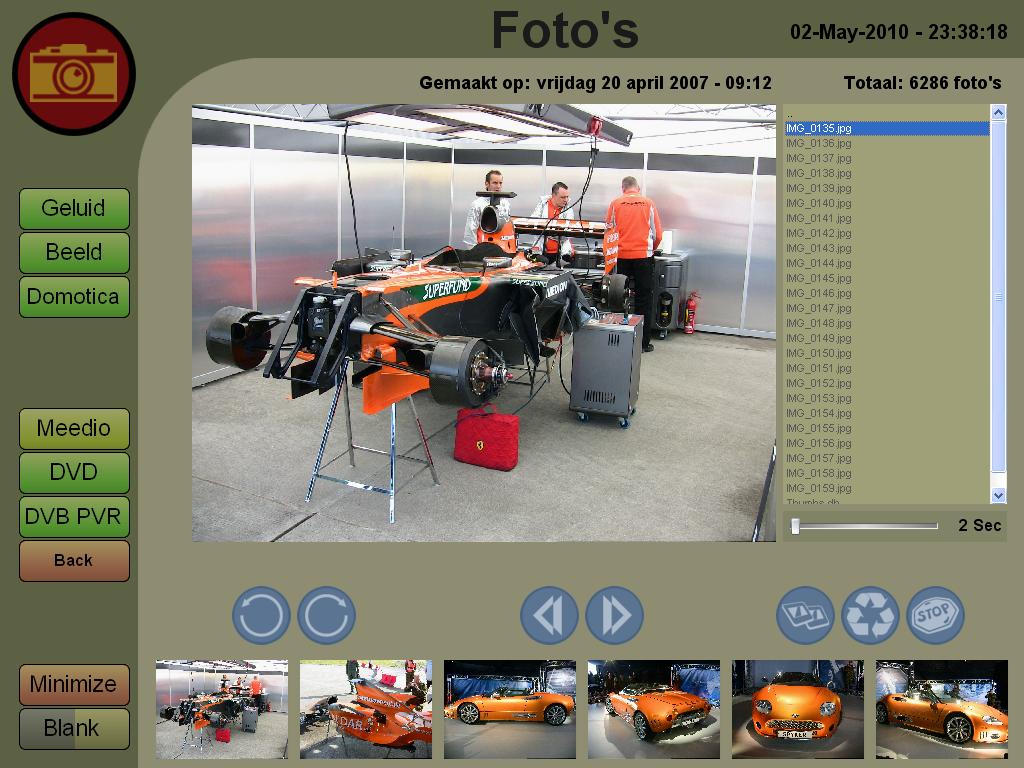

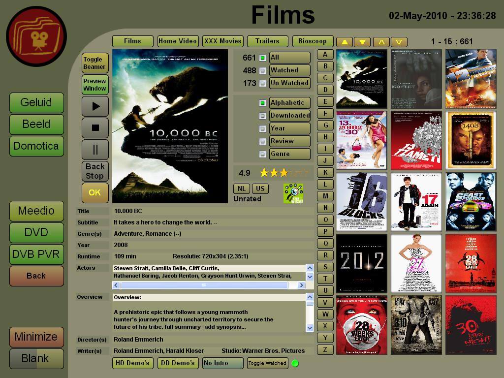

You mean something like 1 or 2 below?

Thats what i want!!!
How do i do that?
Richard, fancy a vacation in North Carolina?
Re: Image gallery on SWremote
Obviously there is some scripting behind it all and the actual data is retrieved from an SQLite2 database. I use meedio to build the databases. Meedio uses SQLite2 and with HouseBot and an SQLite2 COM object I connect to the dbase. On top of all pictures is a button and when it is pressed, you select the picture to view on a large screen in the picture module OR you simply select a movie and jump to the movie details screen. All of it is dynamic so you can jump through different sets of movies or pictures.
