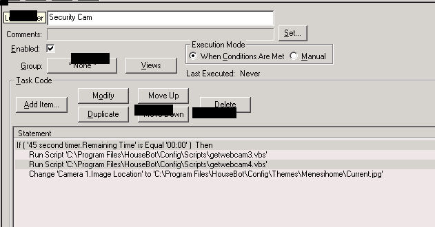

no crashes since my last post, so i have enabled one script:
I did not write the script, it was written By Osler and some other of the great guys from this forum
which is triggered by the attached task.(sorry bout the black boxes my screen grab soft hates RDP).
the other script has been removed for the current test.
All of my scripts are varients of the one posted above.
Pls let me know if you find any issues in the code.
EDIT* while posting this message HB crashed, so i guess this script crashes it...

Re: Housebot crashes randomly
Have you tried removing one of the "Run Script" lines from the task? I'm assuming that the two lines are essentially the same file with file/path names changed to represent the specified camera. I'm wondering if the two scripts are running in the same thread and trying to share memory/variables/etc. If that's the case, you can either combine all of the cameras into one script or make script devices for each instance and then in your task set each script device to "Running" to grab the images. That way each script will run in a separate thread and should eliminate any funky problems.
I am with Roussel on this. Try to comment out one of the two Run Script lines and see what happens.
Ultimately you would want to rewrite the script so that it is simply always running and have the task just trigger an event so that the script starts doing what it should. That way you can deconflict timing much better.
First the one step and then it should be easy to do a rewrite (maybe with a little help if you need it)

The test was with only one script active. I deleted the other one to prevent issues.
I am testing a work around by using webcamxp to take my snapshots and post them to a HB dir for display on the SWremote.
Then i will call this script for doorbell and motion events only to prevent it running every XX seconds.
I am not able to write any VBscript at this time, just don;t know how todo it.
raptor
raptor
