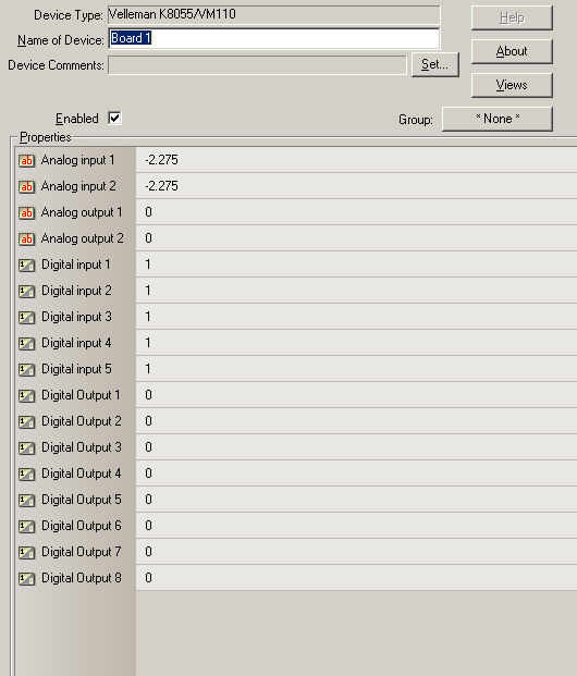

Ok
I used this plugin:
viewtopic.php?f=4&t=856438&p=449296&hilit=K8055#p449296
be sure you install the VB.net from here :
viewtopic.php?f=4&t=856395#p448493
the files go in the following locations:
HB k8055-vm110.dll goes in C:\Program Files\HouseBot\Plugins\Devices
HBDotNetBridge.dll goes in C:\Program Files\HouseBot\Plugins\Devices
HBDotNet.dll goes in C:\Program Files\HouseBot
Do all of this with housebot closed.
Load housebot and you should see the devices load on startup.
When housebot has loaded and assuming there are no errors, goto devices -> add new device -> Software device -> Velleman K8055
and you should see the attached image.
Let me know if this does not do the trick.
Re: Integrate the Vellmen V110 board into HouseBot
Raptor, that's EXACTLY what I needed to know! And it works like a champ.
I glad that you were able and willing to document the whole thing as concisely as that. When I read through all the earlier threads and posts, nowhere did it come clear to me what was being done and what the result was to be. Now I have a better, though not great, understanding of what was being described. With your posting, anyone in the future wanting to integrate the Velleman board into HB will be able to easily see how its done.
Thanks! :D :D :D
