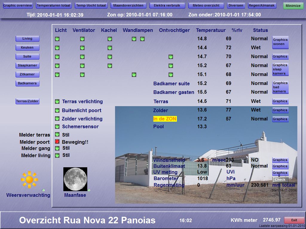

No, the rain gauge is connected to Housebot trough a RFXcom tranceiver unit and the problem is, I don't know how to make a script.
The graphics I need I generate with Meteohub, Housebot I use to control the climate in the house but on the main page of the remote I want to see the rain in the actual year.
