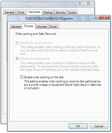

Depending on the OS, there's typically somewhere in the drive configuration that allows you to disable the write caching for the disk. Although it may diminish performance somewhat, I would highly recommend disabling the write cache for the disk that stores the HouseBot database. This will help to ensure that if the power is lost and the machine is not properly shut down that the database will retain the data integrity.
Re: Database Error - Record is Deleted
Here it is in XP:
Start --> My computer --> {Right click on c:, choose properties} --> Hardware tab --> Properties button --> Policies tab.
Highly recommended if you have a machine that is prone to sudden and abrupt stoppage. I have never noticed a decrease in performance - maybe on a general purpose desktop, but never on a single/limited-use device like a HB server.
