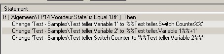

With PV substitutions it works, see attached screenshot.
Every time the state is changing to off the switch counter property is incrementing by 1.
It's working with 2 varibles
Counter task.jpg (18.85 KiB) Viewed 5871 times
