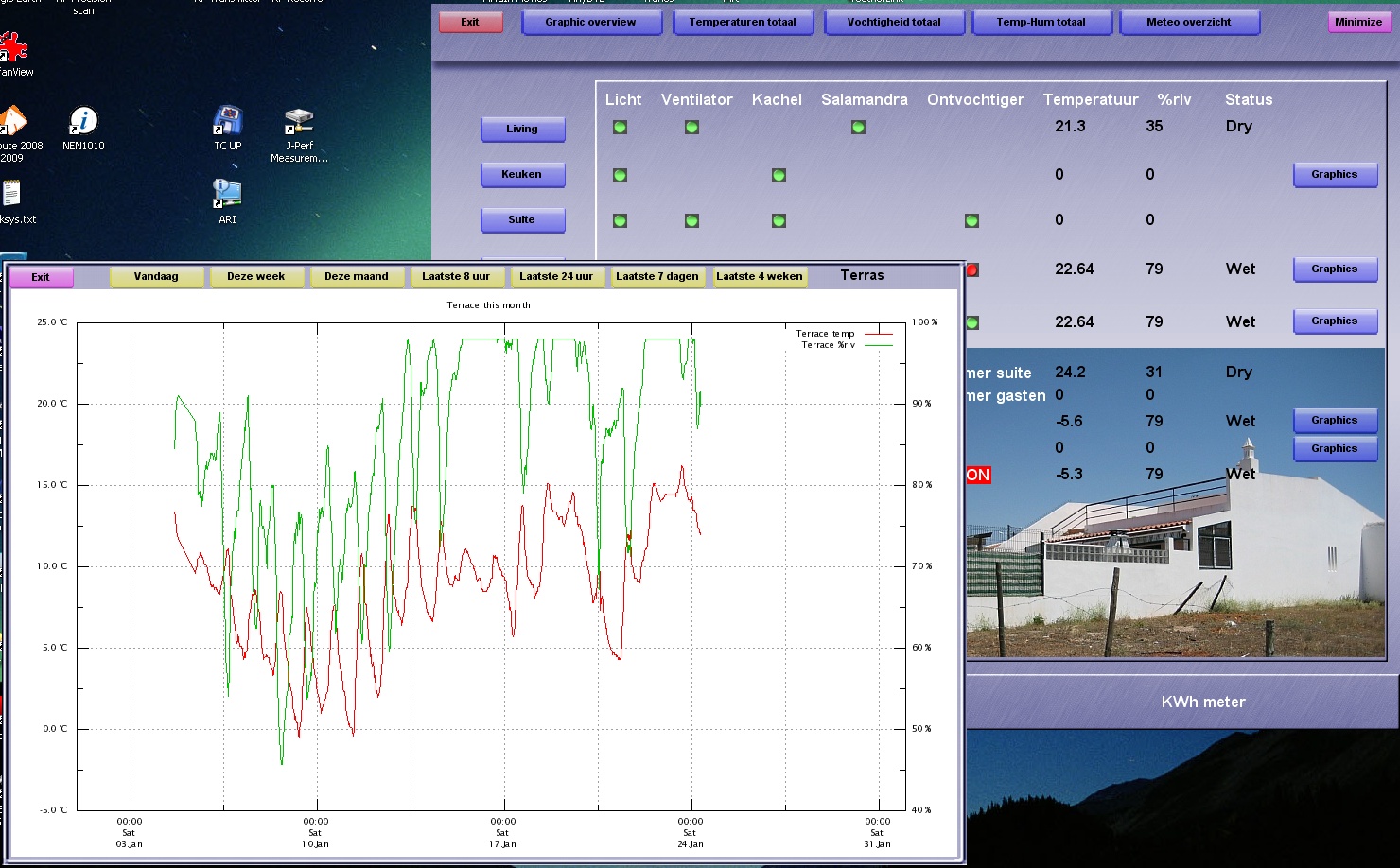

I've found the solution to do this in a simple way to avoid scripts.
I've created a "Null device", added a property "User Alpha1" named this "Image file" and added to the value the initial file name for the start graphic.
On the theme for the remote I placed a property change button for each graphic I want to see thats changing the filename used in the "Image file" property of the null device, works great.
- Graphic HB main sreen and weather graphic pop-up
- HouseBot graphic.jpg (378.27 KiB) Viewed 2505 times
