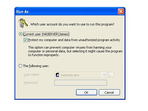

ceejm1
Posts: 32
Joined: Sat Sep 18, 2004 9:58 pm
Re: HouseBot 3.30 User 'Run As' Issue
Post by ceejm1 »
This is the Pop-up that appears.
Gosh. I've never even seen that dialog before.
I'm really confused as to which 'Program' it is asking to run. I wouldn't think it would be HouseBot, since it's already running under the same user account that accepted the socket to the remote (so there shouldn't be a security issue). Is the remote causing the server to run something using the External Control or script when it is getting these messages?
