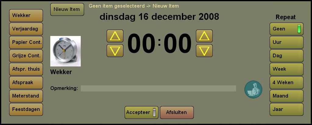

Richard, what does the actual user interface to a set-time type of control look like in your theme? I see from your examples how the timer's value/property could be set. But when Terry suggested the idea I was intrigued by the idea of something more than 3 drop-down list boxes to select hours, mins, seconds. Maybe there is a more suitable existing control that could be used; I haven't looked.
Maybe two buttons (up/down or +/-) tied to a label control (via a task?). Clicking/pressing one of the buttons increments/decrements the value of the label control. Dunno - I'm just making this up as I go...
Re: Date/Time on SWRemote
I change the timer using a simple slider controlling seconds. So 120 seconds would be two minutes. HB calculates values larger than 60 seconds back to minutes. So one slider in your theme controlling seconds would do the job. Obviously if you are not interested in seconds you could go for controlling minutes.
My gui looks something like the attached image Be advised that all controls behind this gui are scripted.
- naamloos.JPG (48.43 KiB) Viewed 13523 times
