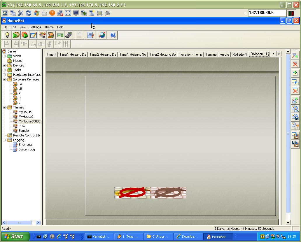

Hi Scot after updating to 3.30 I get something strange. Some of the panels show ... look to the attached image.
Thanks peter
Re: suspicious things after update
That's the 'error image' that you will see if the image specified for the control couldn't be found.
In the past, controls that had associated images that didn't exist just didn't show. This left the control on the panel in an undefined state. Now you can find the controls and either fix them or delete them.
