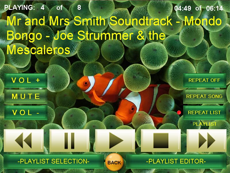

Make sure that the task run when ever the "Conditions are met"
On my ShutDown task for HB I also made sure that HB changed to OFF. This kills the task, since OFF has not commands to to do.
Now in your theme, create 3 property change button and associate to your 'WINAMP DEVICE.REPEAT CMD'
On on button the valve should be 'SEL SONG', the other called 'PLAYLIST', and the last called 'OFF'.
I added indicator too, and a repeat status. The task is still not ironed-out. Like when you have the Playlist Repeat is selected you can not stop the music. Just like quirks I have to work out. I have my computer tell me the "Playlist Mode is On" when I try to stop my winamp device to give me audio conformation to change my repeat. Attached is a screenshot of my music theme with additional music repeat buttons.
