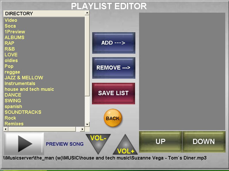

I place a Directory Control Box in one of my themes. When I navigate through the file folder I notice that the files are not sorted by file names (Alphabetize). I do not know what they are sorted by. How do I get my directory Control Box to alphatize my file folder? Is there a setting I am not clicking? Or is the answer right under my nose? LOL.
It doesn't sort them alphabetically (or any other way). Sounds like a good feature request.
I attached a photo. On the left is my list directory box. As you can see the folders are scattered all over the place. Is there a way I can reset or clear the entry in the selected box. Like a refresh. How does HB pull the file folder structures. And I am having a problem with two of my file folders not display their mp3 content. Is there file size restriction on the directory list box? I hope my questions make sense.

James D wrote:...How does HB pull the file folder structures.content.
It just queries the OS for the directory list, and returns them in the order the OS returned them to it. It's probably the same as doing a DIR from a command prompt without any sort options.
