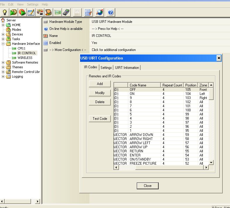

I do not think that the labeling itself will fix the problem. Because under the USBIRT configuration/ more configuration/ click for additional configuration the Ir zones match the present HouseBot labels. So if the label change it will still be incorrect in that configuration box.
James D wrote:Because under the USBIRT configuration/ more configuration/ click for additional configuration the Ir zones match the present HouseBot labels. So if the label change it will still be incorrect in that configuration box.
Where is the "Additional configuration" dialog you are referring to? Is that in HouseBot?
It is under the device interfaces after installing the USBIRT device. The last field is "More Configuration", and to the right the notation "Click for additional configuration" is displayed. You might not be able to see if you do not have the USBIRT device connected and enabled. Attached is a screenshot. There might be another way to get there, or I might not be explaining it correctly.
