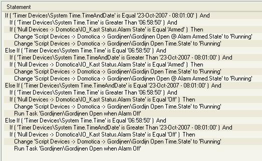

Below one of my masterpieces. It works so I didn't see a need to create a script for it. Some of the Time portion is Sunrise + X-Minutes (themed sider option) dependant. It opens the curtains at around 7 AM when sunrise is earlier than 7 AM and when sunrise is later than 7 AM + slider time, the curtains will open at that time. All depends on the alarm state as well since opening all of the curtains simultaineously will trigger the alarm. This task took a while before it functioned like it should and I guess it should be much easier to build using a script.
- naamloos.JPG (66.62 KiB) Viewed 4104 times
