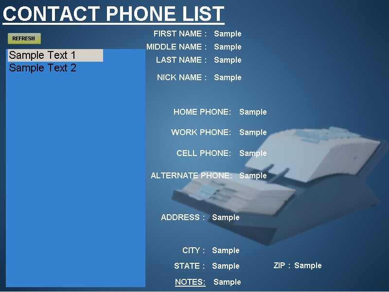

Attached is a copy of my HB Contact List Export. But being new to the "scripting world," I have some questions. The root program is in access. The script program works great, as long as all the fields in access are filled. What I would like to have the script do is, locate wherever there is a empty field in access and place a NA (or whatever I want) to be placed in the empty field (so the field in not empty) and program.

The post does not allow me to post mdb files. So you can PM me and I will forward it to you. Attached below is the script file:

James D wrote:Attached is a copy of my HB Contact List Export. But being new to the "scripting world," I have some questions. The root program is in access. The script program works great, as long as all the fields in access are filled. What I would like to have the script do is, locate wherever there is a empty field in access and place a NA (or whatever I want) to be placed in the empty field (so the field in not empty) and program.
I would just overcome the fact that empty fields produce an error.
It would probably work already when you take out the single quote in front of the "On Error Resume Next" however that is not the way to go. Since I don't have the mdb, I cannot test what you mean.

'On Error Resume Next
szList = szList & "Name^" & rs("FirstName") & vbTab & rs("FirstName") & (" ") & rs("LastName") & vbLF
Not sure how (" ") would work with the () around them. I have never tried it and by reading your script, I suppose it works since you don't complain about errors in that part of the script. I should just go with " " whithout the () because no function (like rs()) is called.
Set rs = dbConn.Execute("SELECT FirstName, MiddleName, LastName, Nickname, Address, City, State, PostalCode, HomePhone, WorkPhone, MobilePhone, FaxNumber, AlternativePhone, EmailAddress, Notes FROM [CONTACTSList] WHERE FirstName = '" & Data & "'")
Seems like you want to get it all. Again, I don't have your mdb file, but if these are just about all the fields there are, I would change all the names of these fields into one single *. SELECT * FROM CONTACTSList WHERE FirstName = bla bla
