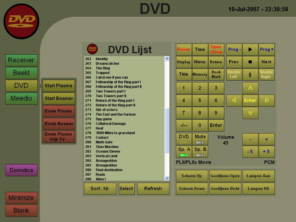

Attached the hbx export containing a theme panel, the script device and script, a task to handle the sorting etc.
The theme panel is stripped from the IR stuff to make the export lighter. The screenshot shows how it looks at my place. This DVD is one of the devices that doesn't have a serial controlled and for that is controlled by IR using the USB UIRT.
