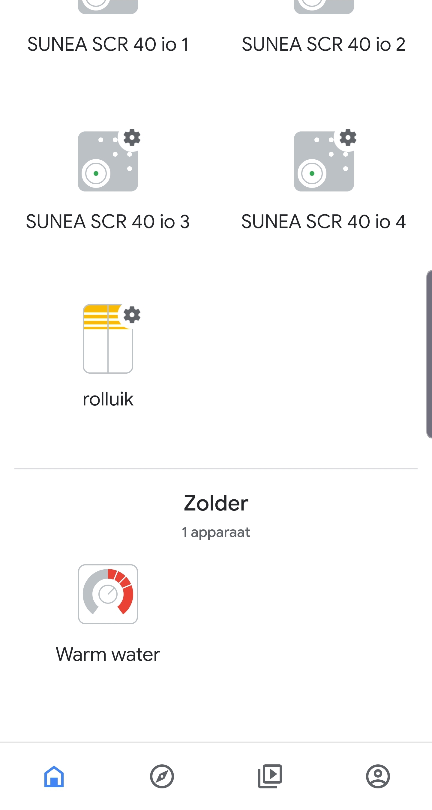

I tried it and found the settings in HB. When I update and sync my devices in Google I get the attached screen. I I press the blind it only shows a setting screen not a control.
What did i do wrong.
Martijn
Re: Voice setup - Google Assistant
You did nothing wrong. That's googles part not fully functional but the voice commands should work fine
