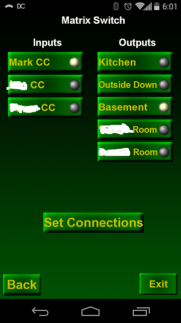

I bought three Chromecasts, and three HDMI to VGA converters. The converters have 3.5mm audio jacks. By adding some load resistors to the VGA converters, the Chromecasts are fooled into thinking there is a display, and they turn on.
I bought an Extron A/V matrix switch (dirt cheap these days since everyone wants HDMI) and plugged my CC with converters into the inputs. Outputs go to individual zones. HB text to speech output will go to another input channel. The switch is fully controlled from a serial port (thanks Richard!) which allows configs to be made on the fly-
One simply selects the desired input, then sets up the output(s), and hits Set Connections to load the matrix.
Then just CC from whatever app is desired. Remote stays with you, stuff you are listening to keeps its place (like podcasts)... we did push all our local music up to Google play, although it turns out there are probably other ways to do that.
