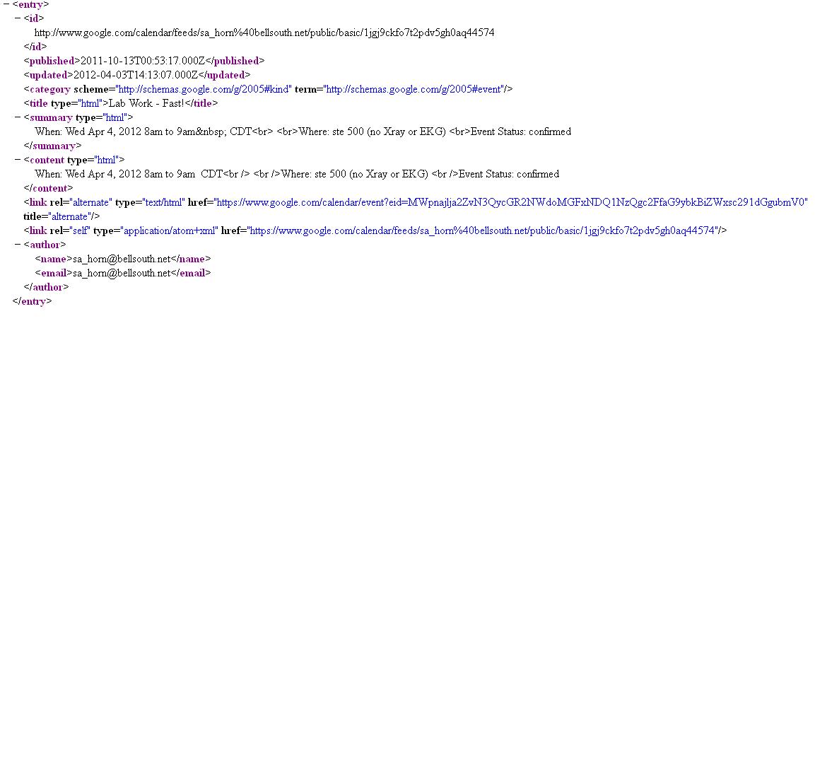

... And it may not be that big of a problem. But what surprised me when I saw the structure of the XML metadata was that the what, when, and where of a typical calendar entry were not separate 'nodes' (if that's the proper designation) of the file. Rather, all the what/when/where is embedded in a 'content' node. So further parsing of the captured content to extract not only the date, event info, but the (optional) begin and end hours is needed.
Here is one complete calendar entry:
typical Google Calendar XML entry
Notice the Content node: date, 'from' and 'to' time etc. are essentially just a string within the node data. Other calendar entries do not have 'from' and 'to' times; they are just tied to a date. So parsing the content data returned from the XML parse call will need to be flexible enough to recognize varying formats of the content string.

You should be able to get to your content node easily with the vbscript xml capabilities, but after that it will be string matching to get what you need.
You could setup a whole bunch of string matches for the bits which are consistent, and then grab the positions of each, break it into sub strings and parse from there's, trim off the bits you don't need.
Or you could look into regex or regular expressions. It is a string matching "language". Very powerful with a bit of a learning curve. There are plenty of sites where you can enter your text and play with regex on the fly and see your results immediately.
