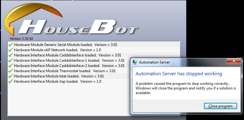

Just to make sure the issue doesn't get lost in another subject, I'm putting my problem here as well
In the post http://cebotics.com/forums/viewtopic.ph ... 0&start=15 I added xAP to HB then tried to add the hardware device which followed with a crash and unable to restart.
It initially crashed when attempting to add the new hardware interface. I entered a name, pressed next and crash. In the above post I have placed an attachment showing where it crashes on restart.
It has created the hardware interface in the DB but some parameters have not been set. Ie IP address, UID etc.
This is on a brand new DB from the install.
Any ideas on what this is?
Neil.

Re: Help required - System Crash when adding XAP.
To recover from this, you could restore your backup database. If that doesn't work, you should get rid of the faulty hardware device using MS Access in your database. If you don't know how to do that and your setup is still very light, try a new install or send it to Scott, he could (maybe) rip the error out of your dbase.
In that case no harm seems to be done. Just reinstall HB and you should be fine.
Post by NW27 »
But!!!
I copy across a new DB fire up HB and yes it is operating again UNTIL I go and add xAP hardware interface then it is dead again.
How do I get xAP in as a hardware interface?
Neil.
Post by Timoh »
I tried... And got the same thing...
My HB dev platform is on Windows 7. But I doubt that's the reason. From experience in writing my plugin, the interface has passed something onto HouseBot that Housebot really does not like.

One quick check. Are you running HouseBot 'as Administrator'? It needs that.

So do I begin with a Doh :D
Yes it works when run as Administrator.
