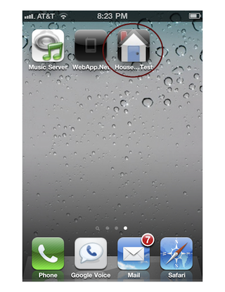

Here's a few screen shots from the sample above that shows the icon on the desktop, the splash screen and the app.
The app's icon on the Home Screen
