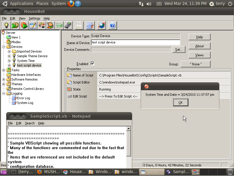

Using the latest beta release of Ubuntu 10.04 and the latest beta of Wine (1.1.41) and copying a few dlls over I was able to install HouseBot, create sample tasks, devices, and even execute vbscript devices. I connected to the Linux HB server from a Windows-running Swremote just fine.

Obviously there's a lot more to work out, and this is just the first steps. Next I'll try mono/.net and the .net plugin. If that works then the majority of stuff I need will be there. Here's a screen shot of HB running in a Wine session on Linux. :-)
HB on Linux in Wine session. Note VB script running.
