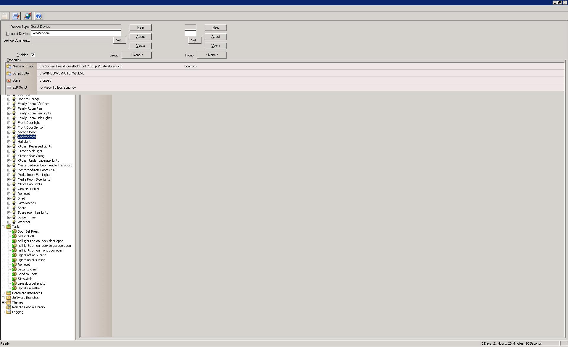

All i am doing is running the script as a device:
Any ideas?

Re: Grabbing net cam images using vbscript only
