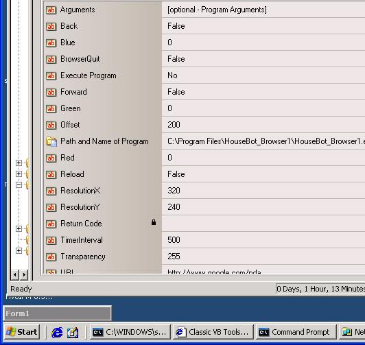

One question: When I launch the browser from windows (double-click in explorer) it launches "normally". When I launch it from within HB (Setting "Execute Program" to "Yes"; it launches "minimized" just in the left lower corner of the screen just above the Windows "Start" button. It has a name of "Form1" (See attached screenshot). Double-clicking on it will restore it to it's normal size and position. Is there a way to have HB launch it "normally" as it does when launching it from Explorer?
Thanks Again!
This is awesome Osler! My mind is spinning thinking of the possibilities for this guy. Thanks so much for contributing such a great add-on to HB.
Thanks Again!

roussell:
It should not launch minimized and I am not sure what is happening. In fact, the form type I used should not show up in the task bar, should not be minimizable (except from code), and should not be moveable by the mouse. Did you download the latest version I posted? I would get rid of all of the previous versions of the app and then download and run the installer. I will add some code to it to force it to show at form load as well.
You're running server 2003, correct. What version of IE do you have?

Correct, I'm running 2003 Server SP1 with IE 6.0 (6.0.3790.1830 to be exact). I did download the latest version and have removed all previous versions of the program but the behavior is the same.
I can try the app on HB under XP (in a virtual PC session) this evening when I get home and see if there are any differences. The interesting part to me was the fact that it launches normally when running it from an explorer windows and only runs minimized when launched from HB.
