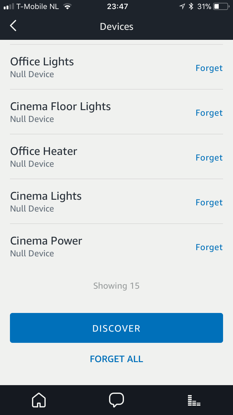

Hello,
I just bought a (few) Amazon Echo's in the USA (Good price
I followed the instructions on http://www.housebot.com/alexa but the echo can't find any devices.
my.housebot.com is working in an webbrowser....
Regards,
Regards,

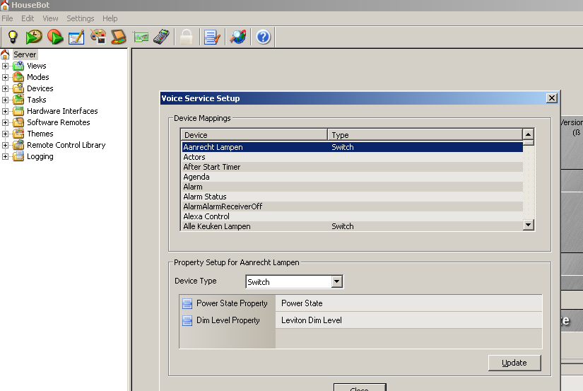

Make sure you have some devices setup for voice control. In version 3.42, go to the main menu / Settings / Voice Service Setup... Make sure the devices you want available through Alexa are configured with the correct 'Type' and property mappings.

Well, in the "Amazon Echo" app I can see an echo device, in Smart Home Skills is the Housebot skin enabled, with the same mail and password as in my.housebot.com.
At my.housebot.com I can see all devices.
Don't know what I miss....

Yes, that is the same as in my configuration.
Some device don't have a dim property so that is empty.

What do you do to Discover your devices? You tell the Echo to discover and/or press the discover button from the smarthome skill?

I can see the discover request from your alexa and it is returning a list of devices (not sure what data, since that isn't logged).
It could be that you have a device or mode with an odd name (odd character or something) that is causing this. I saw something similar during development of the skill. If you see anything that has a name that could be problematic, try removing it from the voice service setup by changing the 'Device Type' to 'None' and saving.

I feel that I'am stupid...
But yes, I try both, ask echo and push the discover button.

It seems you got everythng right. It's just difficult to guess what it could be hence my basic questions.
Scott is probably right. Always is
I would start with just one simple device and if that works, try expanding again. Unless you already tried that as well

Ok
I switched all devices in the Voice Service Setup to *None, only one device to switch and now Alexa find it, tomorrow I will switch on the other device's to find what device (name) give's the problem.
Thanks for all your support.
