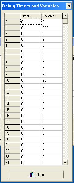

I hit the get variables button and no data was returned.~9:18pm
I exited HB and loaded cmax and did a screen grab of the variables and timers.
I entered data into 4 timers and exited cmax.
I restarted HB and hit get variables. ~9:26:31. My variables where not there, but again my timers where in positions 65+. This was the first I observed this this evening, but it was also the first time I had loaded cmax this evening.
Anything prior to 9:26 was not done by user interaction. So the stuff in 9:25 was logged/performed automatically when HB started.
In looking at the log, it looks like HB captured the some of the activity on the serial port that I did in cmax, but with a delay because the values are incremented by the time it took me to exit cmax and load HB.
I might agree that it is a buffereing issue... Why would HB log the commands I sent in cmax? And something funky in the buffer on the read backs.

- ocevar.JPG (29.61 KiB) Viewed 14866 times
HouseBot isn't seeing the interaction between CMax and the Ocelot. What you are seeing there is some setup that is being done when the plugin is initialized (sets some parameters (auto X10, auto IR, auto IO) and gets a dump of the real time data buffer).
The trace does seem to show the data returned as you describe.

Also, if you go back into C-Max again, is the Timer data you set still in the timer registers there, or did it move into the variables?
